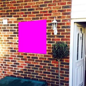

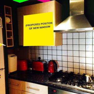

    Putting in a ground floor window underneath an upstairs wall
    Already checked Frank - no approval needed by planning. Quick scamp and he'll sign it off on the day. Was surprised. They seem to have relaxed the planning around my neck of the woods (Epping, Essex) but building regs on my extension were pretty thorough...hard wired linked smoke detectors...
  2. S
    I want to knock a window into an external cavity wall in my kitchen to let more light in as the only other window in there (looking out the back) is NE facing so the kitchen gets quite dark. I realised that there is actually a wall above the area that I want the window. The wall upstairs is...

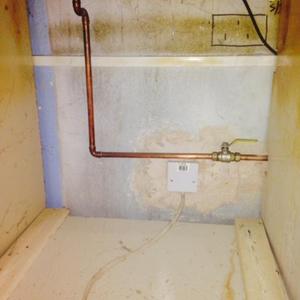

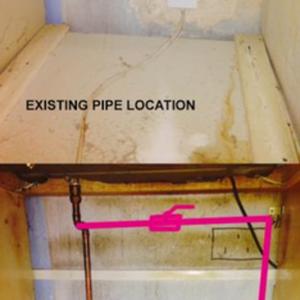

    Electric built in oven not screwing into recess properly
    I was thinking of something like this to re-run the route of the gas pipe. On the video clip the back sides of the oven seem to taper in a bit, so I'm hoping we'll be able to get away with running the pipe vertically up the side. If it misses the back hopefully the fact that it goes over the...

  8. S
    I'm going to take pictures of how the oven was left not screwed in properly to the cupboard recess, then get it sorted by a gas safe professional, then take the issue up with Curry's KNOWHOW team - they shouldn't have left it like that
  9. S
    Yes, I think they've pushed it as far as they can without disturbing the gas pipe. I'm getting a gas safe engineer to re-route the pipe higher up to avoid the back of the oven , so the oven can be pushed flush into the recess cupboard properly without disturbing the gas pipe. Hopefully this can...
