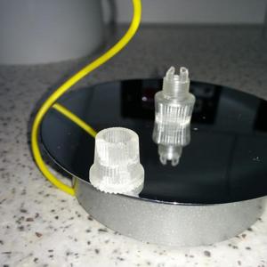

    Cable Clamp for Hanging Glass Light fitting
    Fear not I inspected it carefully and it was very secure the lamp holder end was firmly attached and to the hollow rod, and the cable was held in to rod with a strong and firmly tightened grip. The rob is also earthed as is the rose. I was pretty impressed by most of the design but not with...
    Hi John, I did check but at the bottom the fixing is pretty substantial, the lamp holder fits on the end of a metal tube and the tube holds the weight of the glass shade via a number of smaller spacer rods at the top and bottom so there is no stress on the lamp holder at all. The whole lamps...
    Thanks everyone problem now resolved, I went to the supplier that I got the light from and they provided a new taper cord grip and in addition I added a cable tie inside the rose.
    Hi All thanks for ideas here are a couple of photos of the fitting and lamp: Full lamp: Broken cable clamp and rose: Other side of Rose: Ceiling Plate:
    I have a couple of long glass hanging lights in the Kitchen over the breakfast bar, which were fitted a couple of years ago when the house was built. One of the lamps dropped several inches and when I investigated I found that the weight of the lamp was help by a clear plastic friction nut...
