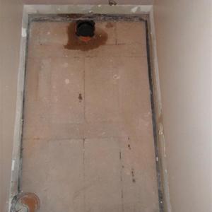

  7. bobdabuilda
    Floating floor replacement in a downstairs toilet.
    A picture is worth a thousand words so here is the current set up. My dilemma now is to either : 1) Hope there is a dpm below the current concrete floor (getting rid of the blue dpm and polystyrene insulator)and pour on a self levelling compound to make up the 38mm deficit- Problem...

  10. bobdabuilda
    I intend laying ceramic tiles on the downstairs toilet floor but on lifting the vinyl floor tiles, I have found that the 18mm chipboard floor underneath, is floating on a layer of 20mm polystyrene and blue polythene membrane. Underneath this the floor is concrete. The house is a bryant built...
