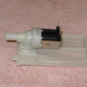

    Hotpoint Aquarius DF62 Dishwasher Problem
    Hi Yardie, Have just had the part fitted by son, all put back together and given it a trial run. All the china and glasses have come out clean no smearing. The salt dispenser didn't empty during the wash as it had been doing before. When I filled the salt dispenser before running the...
  4. D
    Thank you for your help. I found the part on espares at £47 but on ebay I found a second hand one for £10.34 inc postage etc., so have gone for that one. I can return the other wrong part. Will have to wait until next weekend for it to be fitted but glad to have identified the part. Thank...

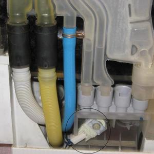

  5. D
    The one circled right?

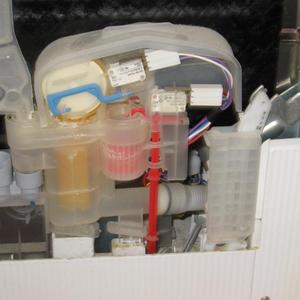

  7. D
    Hi Yardie, My son has come over today to repair the machine and get the lid off etc., I am not sure whether I have bought the right part though. I enclose photos but the part I have bought I think attaches to the blue hose where the main water comes in. Are you able to advise please? Many...
