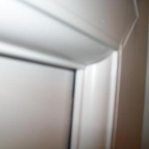

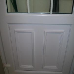

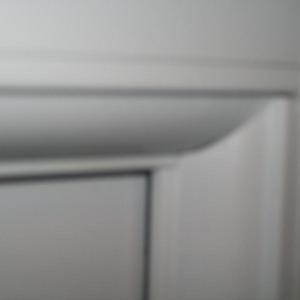

  9. B
    uPVC Door Panel - Removal Help
    Next question related to this. The dimensions of the current door panel are w= 25" h=27.5" d= 27mm I've rang a few wood merchants around here and none have 25mm thick board and they just recommend I get x2 12mm sheets, glue them together and then paint them to build up the missing...
  10. B
    Job done, many thanks for your help.
  11. B
    Cheers CRANK. I didn't put too much effort in trying it the other way as I thought it may not be the correct way. I'll go and give it another go with your directions and let you know how I get on. Cheers
  12. B
    Hi there, I want to remove a door panel so that I can measure up a replacement for inserting a cat flap. I have attached some pictures in the hope that someone could let me know how I would remove the panel. So far I have tried putting x2 scrapers up and under the black seal between the...
