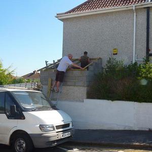

  6. S
    Scratch coat mix for external blockwork extension?
    Can someone guide me on the mix requirements and process to scratch coat a small external block-work extension, including any waterproofing substance to add to the cement?
  7. S
    How to seal/coat a block extension?
    Can anyone help here? I need advice on what products to buy from my local yard, plasticier etc, and then the mix ratios?
  8. S
    Pebbledashing/Roughcasting a new block garden wall.
    Great information above and I'm about to do the same to my small utility extension build with single block - but I'm a total noob. I'm good with general DIY but haven't tried rendering before and need some help regarding the scratch coat onto which I want to pebble dash. Do I need to use a...

  16. S
    That's my intention, hence step 3 of applying the white cement onto which I'll pebbledash...in theory :D but I want to make sure that what I do underneath is going to waterproof the building.
  17. S
    All, I've just had my old utility room roof raised up to a decent height so that I can convert it into a split small bathroom and utility room. The extension is blockwork built and pebbledashed up to where the new bricks start. My builder has left it as pictured below and I'm wondering how...
