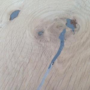

    Bausen engineered untreated oak flooring - blue patches!?
    No ... and it would be a pretty weird way to set about promoting a company even if I was! Ok ... let's leave it. As I said, I'll post some b4/after pix once we're done, and we can see then how it works out.
    We haven't yet got our final stain & finish materials, so can't test yet ... but got to say that I'm satisfied that such a big company with such depth of experience in this area wouldn't just use blue/grey filler for a laugh! I'll post some before after pix once we're done anyway ...
    Ok ... just to update this in case anyone else comes across this wanting the answer ... the technical desk came back to reassure me that any oil or treatment that is put over this type of filler will immediately blend it with whatever finish is being applied. For some reason this way works the...
    Thanks Aron ... but got to admit ... find this very strange. Why use a such a crazy colour? Maybe it reacts differently when you treat it with the wax or oil? Still no answer from their corporate line. Bizarre.
    Hi We've just started laying nearly 40sq m of untreated oak flooring in our hall ... and discovered that most boards have small bluey/grey areas where the manufacturer (Bausen) seems to have used something to fill any cavities around knots etc. We were hoping to stain this floor to match a...

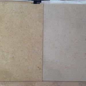

    Limestone ... agh! How to avoid colour change on sealing?!
    Thanks Adam ... but can I just ask ... if honing doesn't change the colour very much, why then the very marked difference (as shown in the picture above) between the front and the back (and, for that matter, all 4 sides) of every single stone tile? We are pretty much committed to the stone we...
    When you say '60 grit is quite rough for honing' ... I don't quite understand: at the moment I'm led to believe that it is the 'honing' that is causing this unwanted yellowish colour. By taking this 60 grit orbital machine to the stone, I'm hoping that we achieve a much lighter colour as a...
    Thanks Adam. Ok ... am now assured that nothing is done to this stone before it leaves the stone shop. It is basically just polishing (and honing) that creates the finished colour! So actually by sanding it, we weren't removing any seal or top layer as such, we were just roughing it up and...
    Was due to get guys in to lay 60sq m of honed limestone on Monday ... when we discover that it is MUCH yellower than we wanted. Basically I think we looked at a tumbled version of this limestone, liked the colour, but went with honed (without checking sample) because we prefered cleaner...
