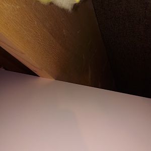

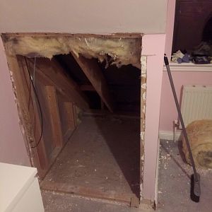

    Drawers install in eaves. Rafter cut?
    Also thinking 250g bags of desicant in the drawers would help.
  2. L

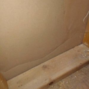

    at the rear right before the backing
  3. L
    Would a vent to the side work?
  4. L

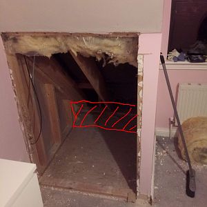

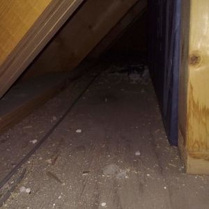

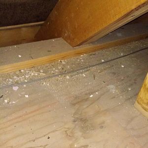

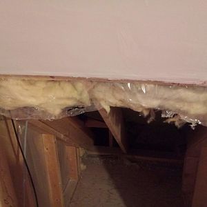

    Firstly, just a point to note: The left and right of this space are internal walls. IMAG0021 by LostInTheUnderflow posted 22 May 2018 at 12:43 AM IMAG0022 by LostInTheUnderflow posted 22 May 2018 at 12:43 AM I am planning on insulating the roof right to the bottom and extend the plastic sheet...

  14. L

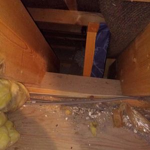

    What surprised me was that the internal walls to were insulated (left and right) and also the roof. but a huge channel (going left and right joining all the eaves) was not. I intend to fix this, but not insulate left and right as these will be internal to internal.
  15. L
    I'm going to extend the ceiling slope down with plasterboard and plasterboard down the sides. And finish plasterboard to unit with decorators caulk.
  16. L

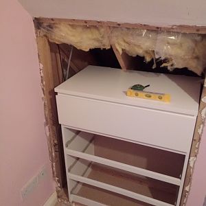

    noseall, can you expand on that? What is your concern here? I've sealed the unit from exposure to the loft space. I put a board on the bottom and 2 fixing holes at the back and sealed with caulk.
  17. L
    Thanks, 1 it is.
  18. L

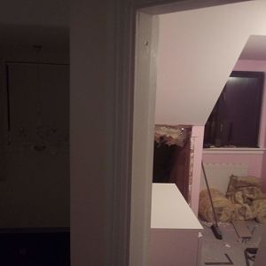

    I'm installing a chest of drawers in some eaves space in a bedroom. IMAG0018 by LostInTheUnderflow posted 20 May 2018 at 10:36 PM The drawers are too deep by 3cm (I knew this when I bought it). I have a few options: Cut into the drawers. It wont interfere with the drawers and wont be seen as...
