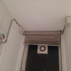

    Here are details of the heater: https://www.towelradiatorstore.com/600x1500mm-Stainless-Steel-Towel-Radiator-Polished.html It is not getting warm despite lights flashing on unit at maximum setting. If the circuit is incapable of supplying the required current for the heater then the fuse...
  14. M
    Electric Towel Heating Rail - installation problem
    Not sure if this is the correct way to upload a pic - here it is: Because the heater is connected to the circuit controlling the electric extractor fan, it only comes on when power is supplied to the fan. In this case lights to the bathroom need to be on for the fan to come on, which...

    Thanks for your replies. I'll upload pics soon. The cable is connected to a fused box inside the bathroom which is also connected to the extractor fan. The LEDs on the heater are coming on, flashing (I assume still not at full temperature) but I would have expected some heat after 30 mins...
  18. M
    Hi everyone, Please help! I ordered a 600W electric towel warmer for my bathroom (there is no heater inside) and got an electrician to install it. He was utterly rude and arrogant and I think he botched the job (charging £380). He fixed the heater to the bathroom wall and connected the...
