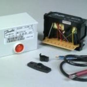

    danfoss control unit re-wire
    Quiet correct Mandate, but the BHO72 still will not fit in the BHO11 base without a conversion base. Don't forget to fit a new photocell as well. See below... http://www.heating-parts.co.uk/product.asp?prd=210010

  5. Paffman
    Your new BHO71 will not fit the BHO11 base. You need to either buy the conversion base that fits where the old BHO11 went in (notice the PCB sticking out of the old box, there is not one on the new box), then the new box will fit. Or buy a new base and do a total rewire. IMHO a Satronic base...
