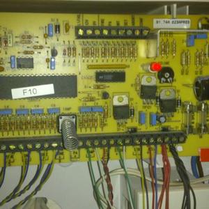

    yeh, its back on now... chime 1 - wait till it beeps, door now chimes again. what do you think then? full nvm reset and programme? from all I can see the sensors ok, wirings ok - no shorts.. just prog1 doesnt arm... prog 2 arms just fine.

    more weirdness.. no when i open door it doesnt chime - with door closed if I put a meter across reed it shows 0, with door open it shows 1 - so the reed is operational.

    tamper light still lighting up for about 1 second.. then off for a second - and repeating that cycle.

    yes - I can open door, walk in front of pir and alarm doesnt fire. PIR light comes on and goes off, door doesnt chime. No lights for any zones come on either. I then need to put my code in and press reset before lights come on for zones.

    just the power light.. the day light goes off when the beeping stops, all other lights also off. If I open door or activate PIR no lights come on. then if i put my code in - it does nothing... put my code in a second time and it starts beeping as though it's setting the alarm. I have just...

    The white sensor is the b4, the brown is the after.. not sure if this is normal or not. if i open and close front door - the light on panel stays lit - if i press reset it goes out.

    Yes I rewired as before.. I staid in the house so i could see if the alarm panel was flashing or anything I'll check for stray wires..

    Hi All, I had a new front door fitted and had to fit a new surface mount sensor. I took note of wiring prior and stupidly just cut through all the wires. It's an Accenta 8. This activated tamper, I put my code in and the alarm stopped. I then proceeded to wire in the new sensor...
