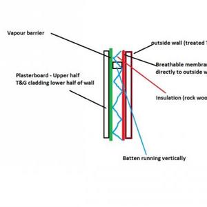

    Must a breathable membrane on a timber wall have an air gap?
    Hi, not sure what you mean John but hopefully these pics may explain better. the cabin I have is constructed like the one in the image attached. I want to create an interior similar to the image attached. Plasterboard or ply upper half of the wall to be plastered or wallpapered and a...

    log cabin wall
  6. B
    The inner or outer wall? Outer is horizontal 28mm thick T&G planks interlocked onto one another like a lot of 'log cabins' Inner will be plaster board and cladding onto battens. I'd assume they would need to be horizontal for the cladding to attach to. Cheers
  7. B
    I have done a lot of searching on this forum but have not found a definitive answer so I hope someone can put me right. I have built a timber summerhouse/log cabin using 28mm thick T&G wall planks. it is double glazed. The Roof and floor I am happy with and both are insulated and finished...
