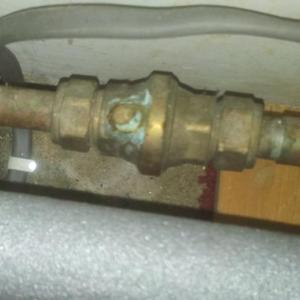

  5. R
    Can anyone please tell me what this is?
    There are flow and return pipes going off to 2 bedroom radiators and this fitting/device is on the return pipe. Anyone know what it is and what it does please?

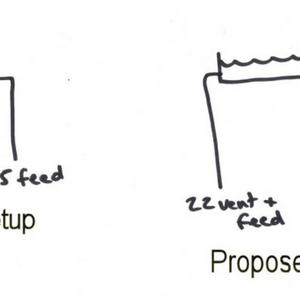

  13. R
    Converting a vented system to sealed
    Ok, I would like not to have to go down the sealed system route if I can modify my system as suggested earlier to the combined feed vent type. This has the advantage of costing me very few £££ to do and hopefully eliminating all the air too.

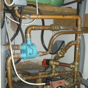

  14. R
    Can I just say that we only moved into this house in April, the only work the plumber has actually done is to fit the new boiler in the garage, he is not responsible for any other existing plumbing in the house. This shows the pipe layout in the airing cupboard . Ignore the arrows on the...
    Yes, the system is in that order although the feed and vent pipes are both connected to an Airjec device.
