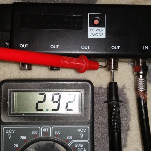

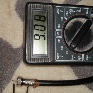

    20150701_210241 by TargetDummy posted 1 Jul 2015 at 9:06 PM 20150701_205939 by TargetDummy posted 1 Jul 2015 at 9:06 PM Couldn't resist checking... First picture shows 9v from the IO link. I checked this f connector and there were no shorts. Second picture shows this connector going into the...

    Lucid, thanks for your reply. I'm definitely getting 9v out of the IO link into the PROception, so I'm going to remake all the f-connections and try again. I'll post results, probably tomorrow. I need a cool drink, it was quite warm in the loft this afternoon! Thanks again, Anton

    Ok, had the PROception delivered and made all connections. I can get a good picture on the 2 'slave' TVs, but the magic eyes don't work. I'm using 2 quite old magic eyes and I'm convinced that it's a voltage issue. I measured 9v coming out of the sky IO link into the PROception and 3v coming...
