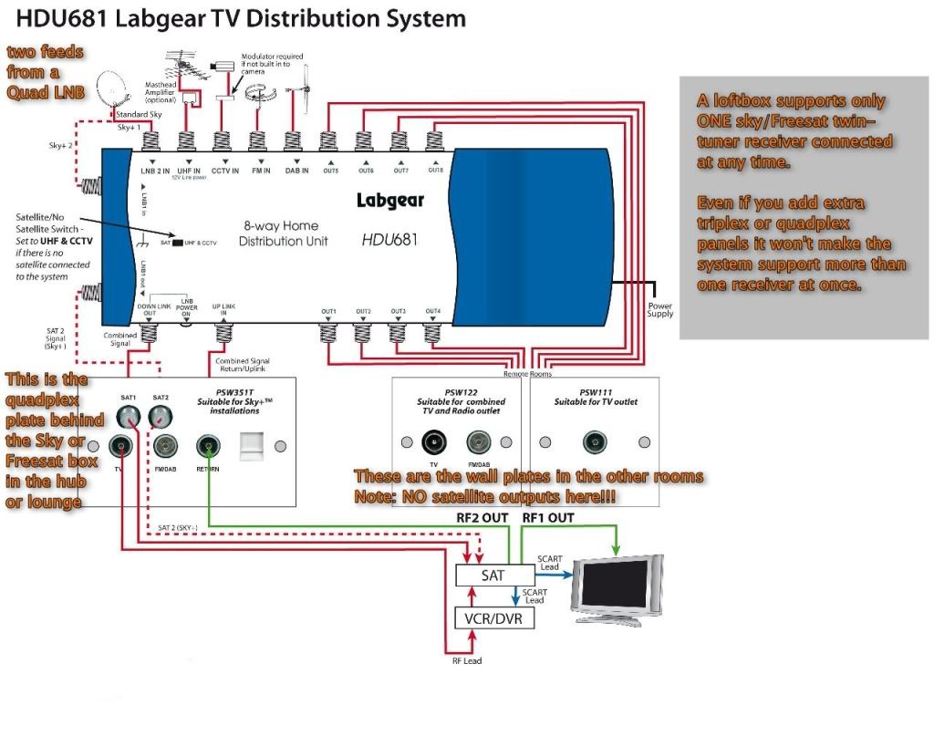

Use the labgear HDU618S its a 8 way distribution, with sky-uplink and eye pass through, so you need one cable from the skybox up to this distribution panel. and of course one cable down for tv signal
There's nothing wrong with the HDU681. Technically it'll do the job you want so if you decide to buy one of those then it'll be fine. However, from what you've written it doesn't seem like you really need all the bells and whistles that the 681 offers. It does have the capacity to handle quite a bit of stuff, but that might be a bit overkill in your situation. Here's a picture of the 681:
Unless there's other things you haven't mentioned, then all you really need is something to take the signal currently going to the bedroom TV and then make that available to all other TVs except the lounge. Well you can do that with any number of products.

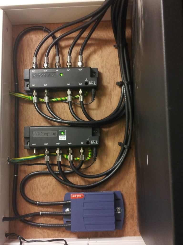

If the Sky receiver's i/o box has its own power supply (which you'll need to run multiple Sky eyes anyway) then you can use something as simple as a ProCeption 1 in: 4 out amp. They do something bigger too; it's a 10-way which also includes features to take in and mix FM and DAB aerial signals to the aerial signal. What I really like about these products is that they're compact and they can be powered either by a normal transformer or from the same supply feeding the i/o box that makes the Sky eyes work. That really simplifies an installation because it means there's no need for a 240V device to be running unattended in the loft.
Here's a close-up of the 4-way. The signal that currenntly goes to the bedroom TV would go in to the "IN" socket. The rest of the TVs are fed from the "OUTs" and they'll get exactly what the bedroom TV got. Simple really.
Here's a couple I used on a small 10 bed hostel install just before Christmas. For this one I needed something small but that also had earth bonding points to comply with wiring regs for multi-dweller accommodation. I could have done this with commercial gear but it would have made the job too expensive. These worked nicely and give great results.

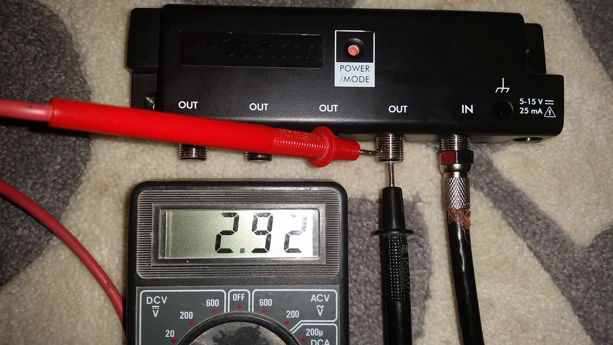

Ok, had the PROception delivered and made all connections. I can get a good picture on the 2 'slave' TVs, but the magic eyes don't work. I'm using 2 quite old magic eyes and I'm convinced that it's a voltage issue.
I measured 9v coming out of the sky IO link into the PROception and 3v coming out on all 4 outlets. Both magic eyes have the red light illuminated but it's quite feint. Should I get new magic eyes or is there something else I need to look at.

*edit* - looks like I should be seeing 8.5-9 volts on each of the 4 outputs. Looks like it could be a faulty unit
Have you got a power supply connected to the I/O link?
Have you checked your wiring for shorts between the shielding braid and the centre pin? The braid wires are thin. They're easy to miss. Just one touching on the centre pin will mess up the voltage for the Sky eyes.

Couldn't resist checking...
First picture shows 9v from the IO link. I checked this f connector and there were no shorts.
Second picture shows this connector going into the PROception and only 3v coming out of it.
I think it's faulty :(

Isn't the output for a IO link supposed to be +ve on centre pin? You appear to have -ve.

The potential difference (P.D) is the same for a battery measured either way.
It has to be measured under load.
So it's definitely a Sky IO-Link and not the Triax IO-Link that I recommended?
I don't know anyone who has got a Sky IO-Link to work with a splitter - powered or otherwise.
Hang on, your photo with the 3 volt reading shows clearly the Proception amplifier without a power supply connected! It definitely won't work like that in conjunction with a Sky IO-Link and it will work with a Triax IO-Link only if the latter has a power supply connected.
So your 3 volt reading is what you get from the Sky IO-Link when it's powering the Proception amp. (Clearly it can't.) There's nothing wrong with the Proception amp.
