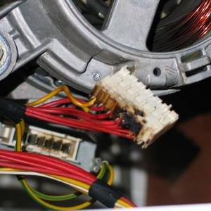

    Burned out wiring & PCB (Photos)
    Haa, just checked receipt and it's actually JUST over two years old!!! Arghh. So do you think it's worth repairing, or chucking? Thanks, Gary
  14. G
    Hi, have problem with my Hoover VHD8412. Programme selector wasn't working so found the main PCB burned out. I then traced the wire on the PCB that seemed to be causing the problem, and found that it runs down to the connector block on the motor where it is badly burned out. My question is...
