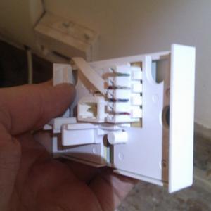

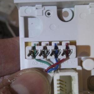

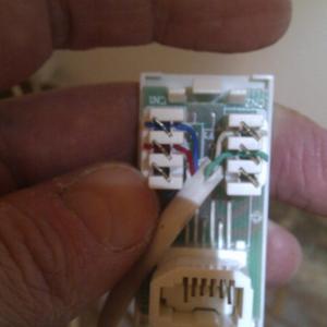

    Thanks Plugwash - it was your hint about stranded wires and using multimeter which solved the problem. As I was running out of time I bought another network starter kit from B&Q for £30... Used Ethernet cable and a proper tool. Phone works now. Overspec for phone use but couldn't afford to...

    Thanks for your tip. Found my multimeter. I think the problem is that the wires haven't been cut by the connectors. When I try the multimeter from connector to connector I get nothing. When I stick the pointy bit into the end of the cables I do get a reading. Is the cable getting...

    >do you have a multimeter? I do own one but can't find, yet... >is the wire stranded or solid? standed >does the phone socket on the front of the master socket work? Yes, that fine. I am looking for the multimeter, does the type of wire make a difference then? Cheers

    Virgin Media second phone socket from master
    Hello all, I am trying to add a second phone point from my Virgin Media master socket. On the back of the master socket it has be numbers 1-6, but there are only 4 connectors. Thinking they would be in fact 2 -5 I wired up the second one as such. However it doesn't work at all. I...
