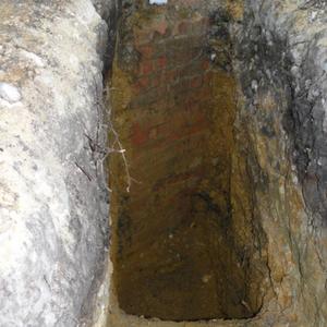

    ok, the resolution is to dig down to just below the foundations of the manhole to a width of 1 metre either side to create "pads". This should mean there is a secure base either side in undisturbed ground. Then once filled use concrete lintels to stop any significant weight on the old structure...

    We found it was part of the old sewerage system for the old street of houses that used to be on the site. There doesn't seem to be any rods in the brickwork - there are steel steps on the inside, but nothing much else. Digging down inside it would be painstaking as it has been backfilled, and...

    Ok, the resolution is that we have to dig a meter wide pad on both sides of the manhole, to the bottom of the structure on both sides. Then concrete and lintel so "no load should be placed" on the manhole. :cry: This seems like overkill to me but I am fairly stuffed :evil: I...

    Hey guess what - The BCO wants to see the bottom of the damn thing. He would not be happy with the footings on disturbed ground. Well the brickie was fairly disturbed when I told him :shock: He has dug one side out and it goes about 7ft down. BCO needs to come again tomorrow to have...

    thanks, the site previously had several old farm buildings on it before my house was built in 1975. It looks like there was an old road that ran through my back garden hence the hard dig. The old sewerage system probably followed the road. All our drainage now goes out the front of the...

    Hi All Started digging out the foundations for a single rear extension of my house. The ground is a bit tough but was going ok until we hit an unused manhole - see pics. There wasn't any metal cover on the hole, it was full of earth. I dug away through this and hit a thin cement plug about...
