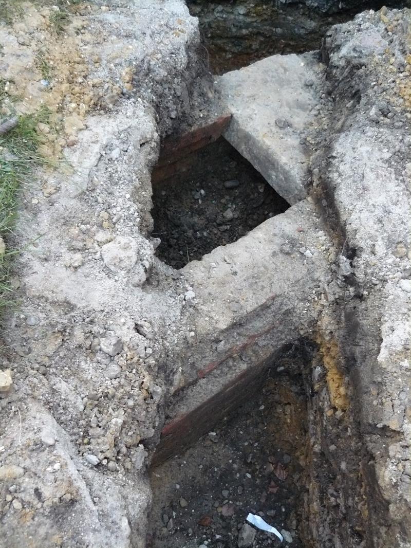

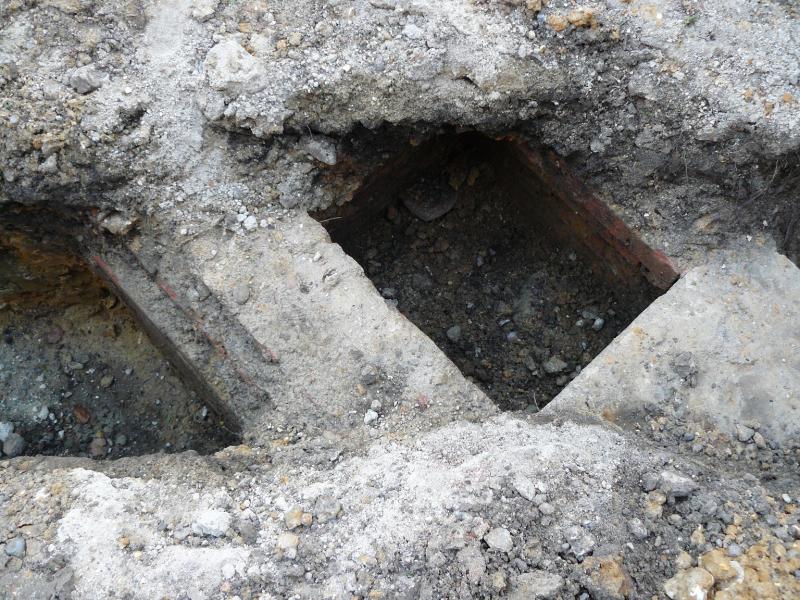

Hi All
Started digging out the foundations for a single rear extension of my house. The ground is a bit tough but was going ok until we hit an unused manhole - see pics.
There wasn't any metal cover on the hole, it was full of earth. I dug away through this and hit a thin cement plug about 40 cm in. Underneath I exposed the first of the metal rung steps before falling into a fit of depression.
I will get LABC out next week but was wondering what experience anyone else might have had with similar problems.
Thanks for any info!
Lee

Hey guess what - The BCO wants to see the bottom of the damn thing. He would not be happy with the footings on disturbed ground.
Well the brickie was fairly disturbed when I told him :eek:

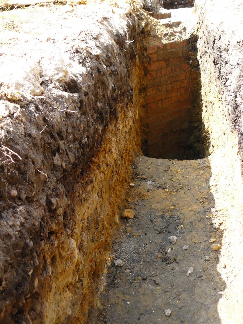

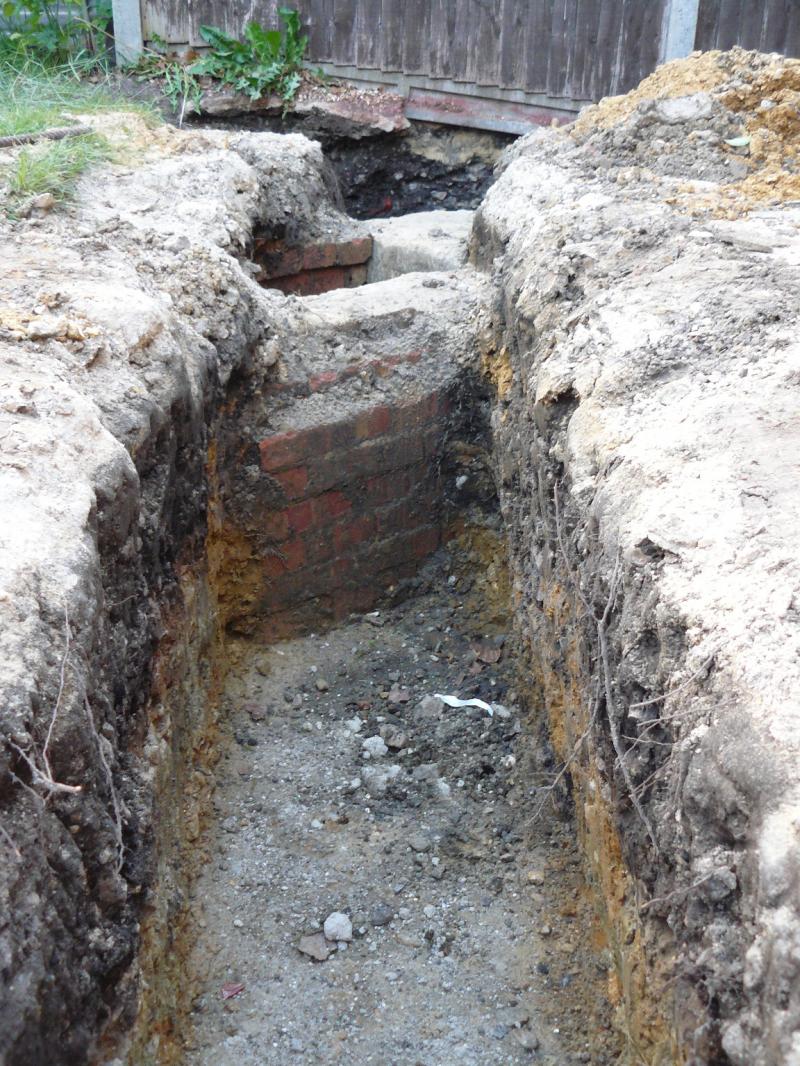

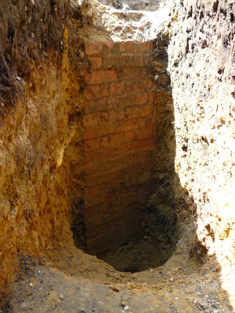

He has dug one side out and it goes about 7ft down. BCO needs to come again tomorrow to have another look and hopefully give me a resolution.
I will remember to take my camera and post some pics.
Ok, the resolution is that we have to dig a meter wide pad on both sides of the manhole, to the bottom of the structure on both sides. Then concrete and lintel so "no load should be placed" on the manhole. :cry:

dig it out inside.. see what's down there.. if it's dry or not..
then either knock it down or fill the bloody thing with concrete ( hey look, a pillar :) )
As stated above filling the thing with concrete is always an option.. either that or break it down below the footing level and put a capping slab over it..

We found it was part of the old sewerage system for the old street of houses that used to be on the site. There doesn't seem to be any rods in the brickwork - there are steel steps on the inside, but nothing much else.
Digging down inside it would be painstaking as it has been backfilled, and is about 8ft deep. I 've gone down about 2ft inside and even at that depth I was using a trowel to try and scoop earth out.
I tried suggesting lots of alternatives to the BCO, including knocking it flat to the footings but he is adamant the base of the concrete must touch undisturbed soil. So even if we did knock it out we would still have to dig down either side to the bottom of it.
