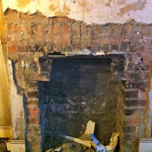

    what to do with this chimney breast
    Hi, I recently pulled out a 50's ish tiled gas fire to open up my hearth for a woodburning stove. The picture shows what I'm left with. I was prepared to prop the brickwork above the opening and fit a concrete lintel, but having removed a bit more render I revealed the original builders...

    chimney breast after 50's tiled gas fire removed
