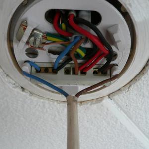

    cheers it's all sheaved and earthed now.

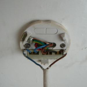

    Can't thank you enough, I swapped the 2 black wires around and now it works

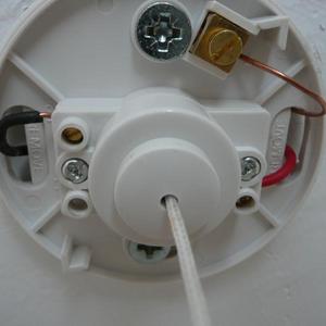

    http://www.diynot.com/network/wobbilyhead/albums/ Hi, Pictures are here the first two are the original rose and light and the second two the new fittings. Hope someone can help i'm hoping to avoid hours of I told you so from the boss when she gets home

    I just changed the wires on the new ceiling switch so now its red to common and black to L2 and now the new light will only turn on if the other is off. When i turn it on and the other is off it'll turn on followed by the other a few seconds later and then it starts to flicker?

    Thanks for the reply i'm still not sure though I have the red cable from the switch, the power and the brown from new rose in the center 3, then on the other 3 I have the blue from the new rose and the black from the power as well as the from the light it's self. And in the 2 section I...

    Hi, I've added a new light onto my circuit by wiring in the new fitting to an existing ceiling rose that was controlled by a one way switch (the new fitting is also controlled by a 1 way) problem I'm having is- I can't turn the new light on without the one the powers taken from being on as...
