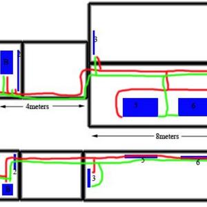

    Central heating design causing cold rad?
    I will take a look at this, not sure how to do this yet, but will give it a go. I will also upgrade the 22mm run to be closer to the large room and this will leave 4 rads on the 15mm from this junction. and the other rads will then be t'd off the main 22mm. so hopefully all that will help...
  2. P
    With all other rads turned off there seems to be little difference. i ave 22 from boiler to end of first room then 15mm from there. I have been wondering if to extend this. it would be straight forward to extend to the start of the big rooms, i.e for 3,4,5&6 rads. extending further would require...
  3. P
    hi all, I've recently fitted a new central heating system and all has been great until the latest two radiators, they don't appear to heat up like the others. I've attempted to balance the system but doesn't appear to help much. I'm wondering if maybe my pipe design could be causing the issues...
