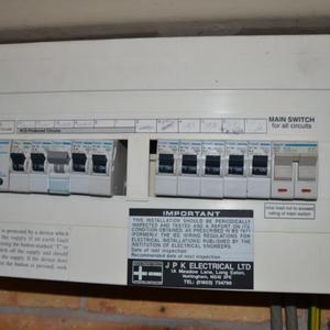

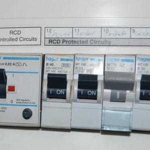

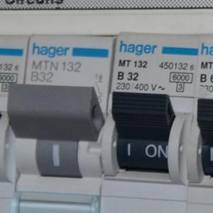

    Wall sockets out but no MCB trippped
    I patiently waited for an electrician and tonight he popped round. He tested the MCB - nothing. Had one in the van, changed it and all working again. Phew Tenner but gave him £20 Happy days for everyone. So... MCBs do fail! Cheers all macker
  8. macker6464
    Cheers guys I think it best I switch my circuit 9 off for the night and get a sparky in. Might look at one or two more sockets for the obvious first though. The RCD works fine - I tested that a few times earlier. Cheers macker
  9. macker6464
    This morning my toast popped up prematurely. It turned out that HALF MY WALL SOCKETS HAD CEASED TO FUNCTION but NO MCBS HAD TRIPPED. I spent all day working out what my consumer unit controlled circuit by circuit fannying about isolating and checking and all that. In summary I have 2...
  10. Circuit 9 - dodgy sockets
  11. My RCD MCBs
    My RCD MCBs
  12. My Consumer unit
    My Consumer unit

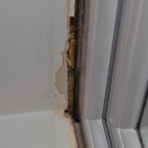

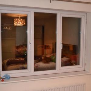

    Sealing internal UPVC – some 5mm gaps
    I have stripped the cracked and loose silicone from the bedroom window UPVC to wall and sill interface. There was also an inch wide flat strip of UPVC on the window sill which I have taken off. I was going to seal around the UPVC frame but wasn’t sure whether to make good some of the slightly...
