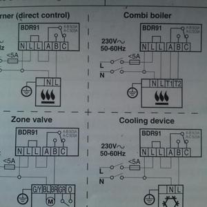

    I'm not a spark, just a DIYer. Although i dont own a tester my dad has one which i use but its not available at the moment. Anyway back to the original question. If you look at the 4 diags for the relay it shows a connection between an L and A which looks like it is inside the relay...

    I only have the diags that i posted pictures of to go on and they do show a connection between the 2 in each one. I guess iv answered my own question as either will do since they're connected in the device itself?

    just realised, the relay box has 2 L's. Which L needs to be connected to A?

    Cheers for the replies guys. Just to confirm, i must remove the bridge between 3 and 4 on the boiler as it says? Also, would it be ok for the relay to get its power from the L and N terminals inside the boiler, marked as Mains Supply: 230 V/50 Hz? I ask because its going to be difficult...

    Hi Guys, I have a brand new Vaillant ecotec plus combi boilder installed and need to wire up my new wireless CM900 thermostat and BDR91 relay box. At the moment i cant see how the to 2 wiring diags marry up so id like some help with what needs to connect to what. combi boiler diag...
