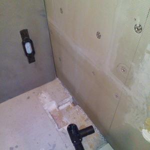

    Hi, The eventual distance from the sink area will probably be 5m ~ to the drain on the other corner. Its going to come out at a good angle, then slope at least 40mm a metre into a drain with some sort of trap (I think this needs to be roddable ?) Then this will feed into an existing drain...
  2. R
    new extension plumbing
    Oh i got it, the analogy helped Thank you. Does the rest look sound ? assuming the pressure is all ok
  3. R
    Hi, Just in general water from the toilette cistern, don't fully understand how it works. Just being cautious. Fast reply - Thanks.
  4. R
    Hi, after doing alot of work myself i'm next going to try and tackle the plumbing - only water. The following is what i planned. Does it look ok ? i've got 2 routes in the concrete floor pre made and one is pictured. I'm concerned at point 1 in the picture of any contaminated water working...
