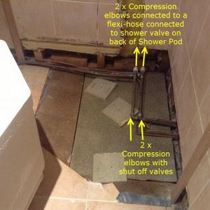

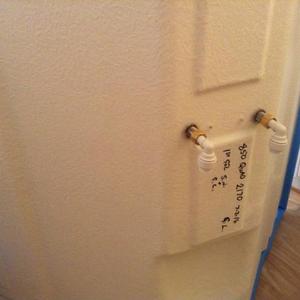

    I am not sure what you mean, Gigz. Connected to the pod? The main problem is, being able to fit any plumbing to the shower valve as well as still being able to manoeuvre the shower wall back onto the wall, and screw it in place, see here, for what I mean: I cannot see, that unless the...

    No, not once the shower pod is screwed to the battens on the wall. That is why I thought of the shut off valves nearest in the image, because I could reach them underneath the shower base cover, should there ever be a leak, with a screwdriver and turn water off. The manufacturer supplied push...

    Thanks Mogget, This is what I plan to do: Then add one of these, a 900MM one to back of shower vale: http://www.screwfix.com/p/flexi-hose-1-2-x-1-2-x-300mm-bx10fpfp30s/66800?_requestid=119124 The reason for the flexible hose, is because it is a two piece shower pod I am...

    Am I right in thinking, that when fitting the compression, with olives, that you close the compression, so that the olives bite and seal to connection, then you re-open (un-screw) the compression nut, THEN put the compound over the olive, and put the nut back on again (re-screw) it back up...
