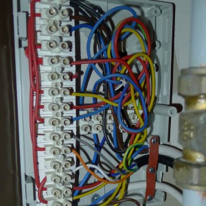

    Fault-finding central-heating wiring
    Hi, it was the mid-position valve actuator. Replacement fitted, system correctly goes through all four states.
  11. T
    Thanks for your persistence. I did already remove the actuator and move the valve spindle. Yep, it's only about 20 degrees of rotation, I'd say it was easy to move just with fingers. Also the valve itself is working - I can change it from A, to both, to B as witnessed by the temperature of the...
  12. T
    Thanks D_Hailsham, however there is live voltage on the grey wire (as per my quoted reply), when it's sitting in mid-position, cylinder is SAT and CH is Called. I am not a trained CH engineer but I can follow schematics and the posts here...
  13. T
    Maybe .. is there a convention to follow there, or are you thinking full-on Dymo name labels?
  14. Wiring Centre Detail
  15. P1040044
    P1040044
  16. P1040043
    P1040043
  17. SteveT Central Heating
    Some pictures of wiring centre internals
  18. T
    1. Yes there is. It's a short link inside the wiring centre. 2. Yes the system runs under that condition. Voltage is present at the grey wire in the wiring centre, whether the cyl stat is set high (call) or low (sat). Part of the wiring centre detail: 16: CYL SAT .. two black wires going to...
  19. T
    Will investigate 1 & 2. 3. I was mistaken on - I corrected my post perhaps after you saw it. I meant to say grey + white.
  20. T
    I've had more of a look this morning. The motorised valve is an EPH Detach B322D. This was a replacement, fitted July 2013. Apparently has a 5-year guarantee. The wiring in the wiring centre is rather untidy, but the correct signals seem to be present on the grey, white feeds according to...
