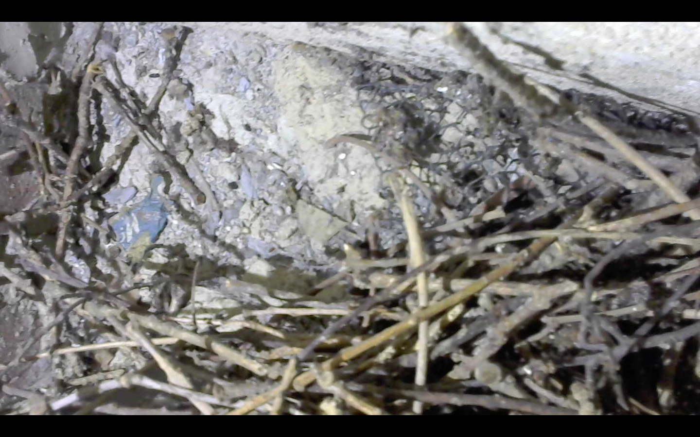

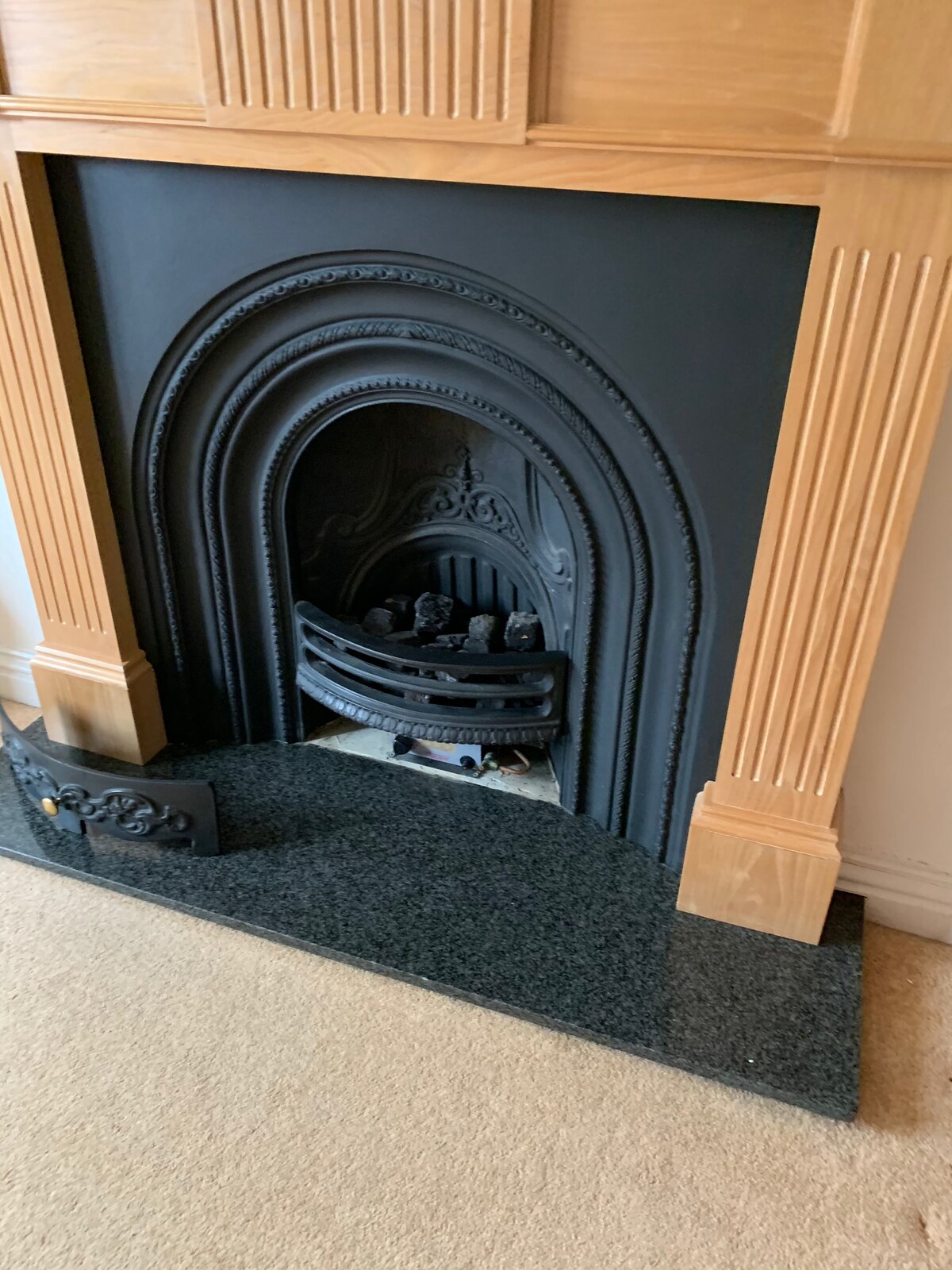

We have a gas fireplace as shown. Recently got the chimney swept (there was a lot of sticks and birds-nest up there). Got a cowl fitted to stop them coming back.
The sweep said it wasn't right that we had a void at the back of the fireplace (which was also full of sticks).
A lot of awkward work with a vacuum cleaner and a litter-picker has got the void clean again (final pic).

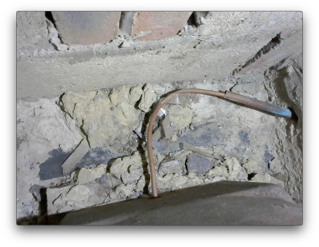

Sweep suggested we fill the void with Vermiculite. Should it be finished with a concrete mix to form a shelf?
Should that copper pipe just be encased in it, or does it need protection with some kind of surround?

That looks like a gas pipe , you encase that in concrete and it will corrude
You have a gas fire , if a cowl is fitted then that void won't be an issue again , why was the sweep so bothered about it? Was it because it makes it easier for him to clean if you block it up?
Isolate the gas pipe - there should be an isolator to the right of the chimney breast .... there should be?
you need a gas safe to come out to inspect and test the installation and remove the gas fire (and later replace it).
Removing the fire you will have a free shot at any void. vermiculite's not needed.
As above, the gas pipe needs maybe repositioning, dont bury it.
Gas fires usually have a liner up the flue and a gas approved cowl.and a carbon monoxide detector.

Thanks. I agree the cowl removes the main problem.
If he sweeps it again in a year or two, I suppose more stuff could come down (cobwebs etc) which could collect there. The idea of backfilling is to avoid that.
Had a gas-safe eng out to service the fireplace and give us his opinion. He agreed the backfill was not necessary, but would do no harm. He brought a huge bag of Vermiculite with him, and filled it for us (up to about 5cm under the cast-iron back plate height, so wind won't blow it out too much). he also refreshed the filler under the fake coals.
This is a dry fill, and removable. No concrete.

In future, if you annotate your pics you will be clearer.
Removing the fire would have allowed you to make good the broken back hearth and investigate and make good the gaps in the rough back wall - there might be another void behind the back wall?
What purpose a 50mm bed of loose vermiculite serves i dont know - at worst it might somehow interfere with the operation of the gas fire?
