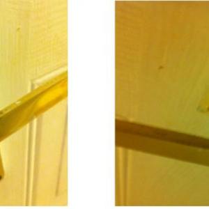

  14. M
    Problem removing door handle
    So I'm trying to remove my bedroom door handle which I'd like to replace. I've removed the face plate screws but can't disconnect the handles. I've looked under each handle and I see no allen key hole. Can someone point me in the right direction? Mark [/img]

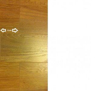

  17. M
    Laminate flooring Question
    They do seem flat, think I'll just leave it as it is like you suggested.
  18. M
    I've laid some laminate flooring and realised the gap between the boards is quite close 8cm. (See photo). Will this cause a problem, should I take them up and make the gap bigger? Mark
