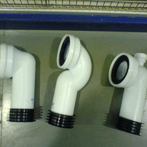

    Changing an old toilet
    ^^Very posh, dont think id get the hang of that one though, up against the wall like that :) I'd say im fairly confident i can get the old toilet off along with the cistern. My concern is will i need to raise the new toilet or perhaps encounter problems connecting it to the soil pipe. You...

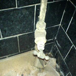

    I would like to change my old toilet. But the pipework and fittings are very old (1960s?) and im a little concerned about a new toilet not having the same design. The pics below show the different parts: As you can see its such a miserable place in which to take a...
