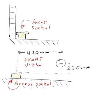

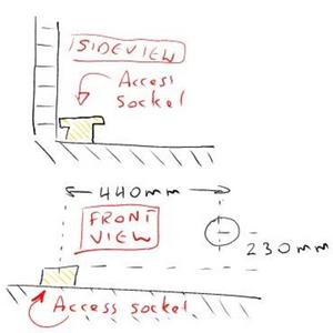

    Here's a diagram of what I've got...

    yeah, I considered that. I've only got 230mm from the top lip of the access to the centre of where I need to enter the wall. The lip of the brown acess socket where it comes out of the ground is actually TOUCHING the wall. Is this normal? Andy

    Help! I've hired a corere ready to fit the soil pipe for a new downstairs bathroom and I'm perplexed... The soil pipe sticking out of the ground that my builder put in for me is VERY close to the wall. I've offered up a 90deg bend to the opening and there's just no space for the plug-end to...
