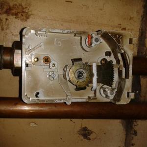

  8. automated valves
    automated valves
  9. N
    Central Heating Programmers keep breaking
    Hi All, A big thanks to everyone who helped. Problem was on the automated valves. You can see on the pictures; one of them was corroded, this was caused by a minuscule leak. the other had plastic failure, the posts which held the return springs have bot broken off so the valve was...
    No backplate was not replaced, old one was examined carefully and seemed to make right connections. Contacts were tested to be wired correctly.
  12. N
    I will check the zone valves and report back.
  13. N
    If this is the case, could it be causing the programmer to fail? And then why did it work as normal for a few months after the programmer was replaced?
    I have an old floor standing gas boiler CH system with hot water storage tank. This has worked just fine for few years. The only things needing replaced were the HW/CH valves that control the water flow. Problem The control unit Horstmann Centaurplus C27 Heating Programmer broke...
