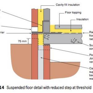

    Hi noseall. So if there was no need for radon protection would a cavity tray be formed at dpc level?

    This is the Image I found for the Bricklayer. http://media.diynot.com/147000_146482_40127_40270406_thumb.jpg

    Hi Rickie21. Can you confirm then that the sole purpose of a cavity tray is to stop water penetration into the inner wall and has nothing to do with radon protection. Cheers.

    Just come back from the site and I do think now that this Bricklayer doesn't know what he's doing. I have given him the drawing that I got from the Radon report, so he can now visually see what the setup is. He then started questioning the cavity tray, saying that it wasn't needed because...

    Hi. I am looking for some advice on a problem that I am having with the Bricklayer that is building a property for me. He constructed the footings for me and then after I layed the block and beam floor he started to lay the external walls. I had to do some research myself to find out...
