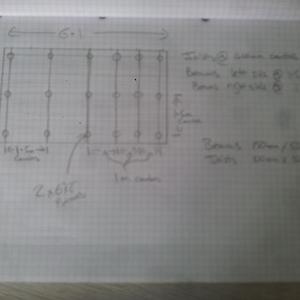

    another decking thread
    so i could use joist hangers to get my 400mm spacing and just use 6x2's with posts at 1.2m centres rather than 6x2 beams and a seperate 4x2 frame on top to get the 400mm centers?

  14. R
    thanks for your reply so ill put all the posts in at 1.2m centres I take it the 6x2's are fine as beams - realised i made a mistake earlier and put 1.8m instead of 3.6m beams Then double up where ever the 4x2's meet so they are supported. So for the 4x2's it would be best to put them at 45...
  15. R
    sorry if been asked a hundred times but not been able to find any clear answers i have been looking for for the last week or so. the plan is to build some decking 6.1m wide x 3.6m deep with the right hand half being used for a hottub. What im planning on doing is using 600mm x 100mm x 100mm...
