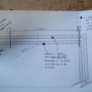

    Order of work for fitting RSJ's
    Hi All, Hopefully the below sketch will show up. I am essentially having a wall knocked through in the gable end of my house from the corner of the house between the points A and B in the diagram and am interested to know the order of works for this that people would advise. We are...
