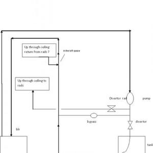

    Pump direction
    Hello everyone, I still have the same problem and have taken it a little bit further. I have changed the divertor for the central heating and I have proven the bypass is not passing. I think it is reverse circulation as per moggets comments and I have attached a drawing of my system for...

    Pump direction
    Paul, spot on, I do have two 2 port valves (controlled by actuators), sorry for the confusion everyone. I have replaced the two port valve for the central heating prior to asking for everyones help as I thought this was passing and indeed on stripping it down the seat was worn. I still...

    Pump direction
    Would the direction of water flow from a pump in a system have any effect if it was incorrect? I am having problems with my radiators becoming warm when hot water is only selected. It cannot be the diverter actuators on the danfoss valves as I have replaced these. It cannot be the valve...
