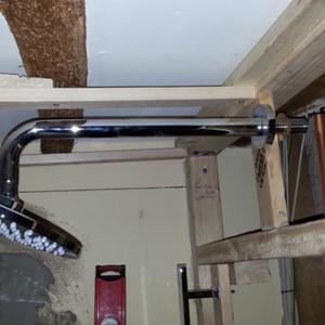

    Shower Arm Fitting Advice
    I'm in the process of fitting a shower in our bathroom however i'm a bit stumped as to how to tackle fitting the shower arm/head. The shower arm came with a threaded section and large brass nut which i assumed i would need to tighten and it would clamp itself to the wall however the shower...
