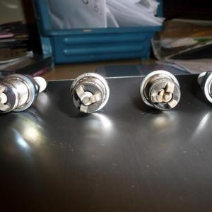

    Hi Mursal Plus look fine no Oil or sooty deposits just grey / brown on colour, they are NGK replaced last January. I had a Scan done on the car Ross Tech? No faults found in the engine module apart from the 2 Codes mentioned so does that mean Lambda sensors are OK? Bugs the hell out...
