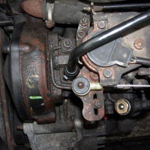

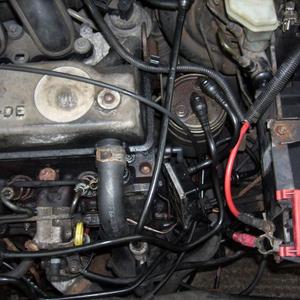

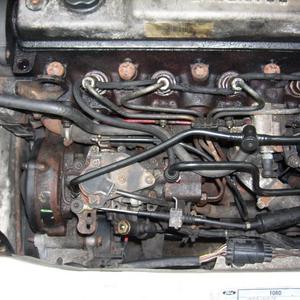

    1998 ford courier 1.8 diesel starting problem
    pics are on my profile lol couldnt get them onto the thread for some reason :(
  9. A
    hope these pictures help! i will try get a video of me trying to start it and post a link maybe someone can tell from the sound cheers
    hi guys iv recently just tried to start my van after a long time being stood. it had a full engine build 1500 miles ago, it is turning but not firing?? i have checked plugs and they are fine, fuel is coming out of the rack when turning over but not at high pressure. does anyone have...
