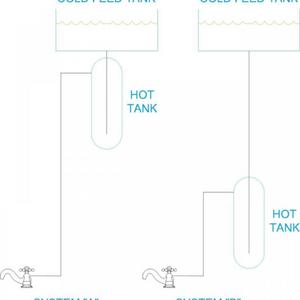

    Ok, just been crawing about in the loft, there is 5150mm from FFL to apex in loft. (Bungalow). The cold tanks base is about 4520 above FFL (finished floor Level) In that space there has to be accomodated a woodstove, a hot water tank, heat leak rad and cold feed/expansion tanks.... in that...

    http://www.diynot.com/network/PeedOftec/albums/ Ok, I have posted an image into my album. Not sure if this is the correct way to do it but only way I know at the moment... Cheers for the comments to dates guys, impressed by the quick responses!!

    The tank is an ACV SLME300 http://www.acv-uk.com/slme.htm
