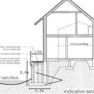

    Static, I believe the only stupid question is the one you don't ask so here goes.. are you sure you are looking at the sketch correctly? the only way to do maintenance to the block wall will be to excavate out the loose fill down to the base (~1.6m) thereby opening up a 650mm cavity on the...

    Static. How will a pure RC wall last longer than a filled cavity. The pure RC was going to be 200mm thick compared to 150mm cavity but the cavity RC will be sandwiched between two 100mm block walls with lots of wall ties. The steel skeleton will be much the same whichever method. Also the...

    Thanks oldun for such a comprehensive reply, especially since you didn't have all the info. We have certain things forced on us by the Environment agency (coffer dam) but we also have some things going in our favour (hopefully). The drawing shows the section, the existing building is a large...

    Gabions are used on the stream in places to stop erosion, they have been ruled out here, once the retaining wall is up foundations for a new hose will be built, the reinforced concrete is the solution agreed by 2 different structural engineers. My question is shuttering or build a block cavity...

    the river is really a stream and at this time of year only about 20cm deep about 3m wide but can flash flood. We have to build a coffer dam (just sandbags) to keep the footing dry, the foundations are to be excavated below stream level and the base 200 to 300mm deep about 1.5 m wide. I intend...

    I have a 33m long by 2m high reinforced concrete retaining wall to build along a riverbank which will then be stone faced. I have two solutions from the structural engineer 1) hire in shuttering and pour the concrete 2) build a 150mm cavity block wall and fill that with concrete both will have...
