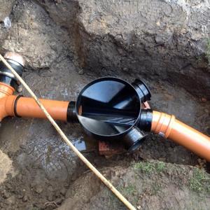

    Yeas pipe are close to surface about 10-15 cm but most of the time they probably be dray as it will only be used when some one in sauna and needs WC other then that also washing machine

    :) do you think that there is some people who put flexi pipe undeground what about this conection I Realy don't want to dig around that clay pipe also there is another acces chaimber I instaled on to

    Dig trench today fall is ok just pipe is about 10cm below ground at highest point white flexible conector just to check flow

    Thanks I will see tomorrow if my chamber wil fit in that space as this clay pipe is coverd in concrete witch is very dificult to break,without braking clay pipe .yes My end of garden gains in height. Probably fall will be sufficient .

    Update after diging more as suggested found clay pipe about 30cm below ground and was covered with concrete exposed and attached news plastic conection after calculation I can only lay new plastic pipe about 20 cm below to get decent fall or the is any other way ? Thanks

    Thanks for answering. I pulled out plastic pipe and measured drop I have cast iron exposed about 8 cm out of concrete. Concrete slab itself is about 10 cm below ground What if new pipe fall is really lower than existing what is my options ? Thanks

    Thanks for advice I marked on picture where the pipe will coming and joining the existing drain if I instal manhole close to existing drain By the time my soil pipe will be lover about 15cm then original clay pipe. And regards building reg I spoke with councill told them tham will be building...

    Ok then pipe runs down about 10cm below concrete then bends left my house is semi and runs towards my neibourgh main manhole is probably on the street as I and my neibourgh don't havit and is shared as house built 1940 I will laying new soil pipe from outbuilding just came from b&q can this...

    Ok thanks any idea witch connector to use in that case ?

    Hi need help with project distance from new toilet waiste pipe to house main sewer is 15meter with fall 1:40 that's 37.5cm i'm right ?question is how to conect new pipe in to existing my house is semi and all sewer conects to one my pipe bends 25cm in to ground towards my neibourgh sorry if not...
