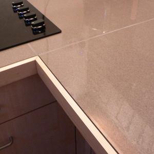

    just asking for a bit of advice..porcelain tile on osb&backerboard..grouted with mapei ultracolour plus in mid grey..timber edging..what to fill gap (4mm) with? grout?..colour would be identical or silicone (Everbuild "Grey" -25% flexibility factor"?) or caulk/external frame sealant...

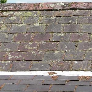

    >Xenon..thanks..it's a fair point & I will do. Not trying to be clever but it's an annual job here as it goes..Autumn usually..a right pain as no sooner have you done it it starts building again. Problem is the stuff you can't see! We had a 15 ft. bough fall on another section of the roof...
  13. E
    lead failing?
    NW facing roof-line..2 pitches because of extension to original outer wall in room below (ground floor)... job done c.1990. 20"x10" slates and roofing membrane underneath both sets of slates. Lead sheeting used where the pitch of the roof alters (see photo)..underlying the 2 rows of slates...

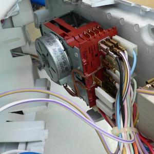

    top loader..given to us some years ago..build date c.2000 I think. Has been fine for years apart from the odd belt..but then recently has started being difficult to start. Electrical fault of some type I think as once it is going it washes /spins ok (though I think the wife said it missed the...
