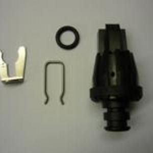

    Pressure Sensor Vaillant ecotec plus 824
    All done - I thought the same as well - the thicker pin is for another type of fitting Although it seems lose, it is sealed and running fine. Had a f.75 error, changed the pump and was resolved - however noticed that the Pressure was building consistently to more than 3 bar and staying in...
    I am replacing the orange pressure sensor on the Vaillant Ecotec Plus 824 with the new black pressure sensor, however the fitment seems much too loose on the black pressure sensor. The black pressure sensor has come with a thin locking pin, the washer, the sensor and another thicker locking...
