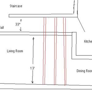

    That's great then, I didnt want to leave a couple of inches of wall to make up the 150mm. I am removing 2.5-metres of wall though, so hopefully Duvet's figures wont apply.
  3. Gilesda
    Lintel end bearing
    I've been digging around the internet & everything I've read about lintels says the end bearing should be at least 150mm. Is that not correct, or does it depend on what the lintel is holding up?
  4. Gilesda
    Lintel end bearing
    Hi all. I want to remove part of a block wall which doesn't extend upstairs, but it does have the upstairs floor joists resting on it. The joists are at 90degrees to the wall. The sketch below shows (hopefully) what I want to do, the gap in the living room wall is what I will knock down &...
