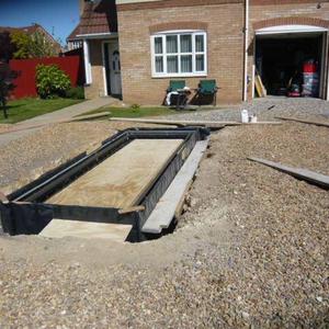

    Vehicle Inspection Pit

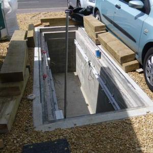

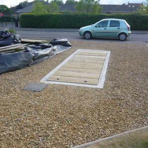

    Well, it's all finished. Wiring going in lided up gone!

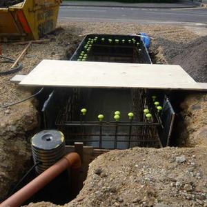

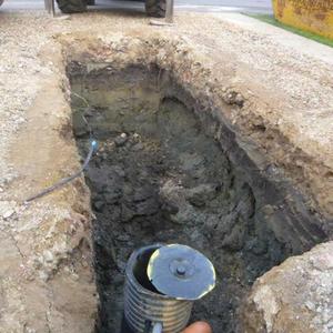

  6. redpis

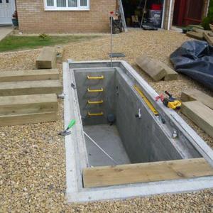

    Hi Mattylad, Pic 6 shows a pipe with n off cut dustbin lid on it, at the bottom of the pipe is a pump, I didn't tray and waterproof the pit, as you are quite right, it will soon get water in it from rain or us washing the car. Leeco. Thanks for the heads up on the spiders (mental note...

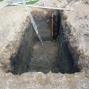

  7. redpis
    Wotan, Didn't need permission, checked with the local authority before considering the project and have their written reply to that effect. Engstudent, Its the only place for it to go :-) I have more pics showing how it is now, to directly answer your question, the pit is covered by 5"...

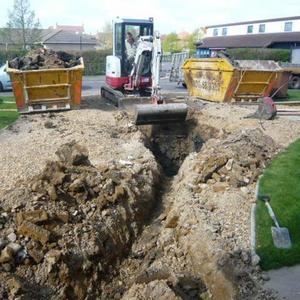

  8. redpis

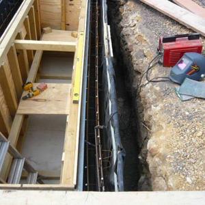

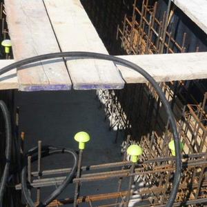

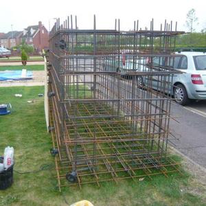

    After many months of diliberation and fact finding (including a huge thread on DIYnot), finally started work on the pit. All started really well, and went downhill from there lol. Underestimated the number od skips by one (4 x 12yrd needed) so a bit extra money went on that, the main...
