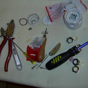

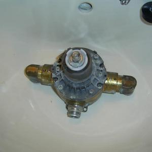

    Urgent Help Please
    Ok after visiting B&Q and picking up the parts came home and started, you can see the shower unit now sits in the sink!, bits and bobs on the chair and finally the incoming pipes with the new valves. So far so good as there is no leaks, yet - I'm not optimistic. We'll see if my handy work...

    Urgent Help Please
    Ah yes they are just visible, probably enough to get a spanner onto them. Right here goes nothing, maybe I'll go to B&Q first and get the parts! regards, Kevin.

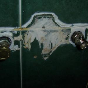

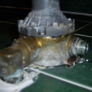

    Urgent Help Please
    Ok pics of broken shower :(

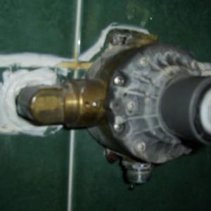

  9. Untitled
    You can see the water leaking out the back of the unit, its seems to be getting worse :(

    Urgent Help Please
    I meant ot say its a surface mounted Triton LP Mixer and it looks like the feed come out of the wall and into the either side of what I would call the main valve. Therefore whilst it might leak it looks like nothing is going down the back of the wall - any thoughts? I know I'm not giving you a...
