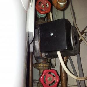

    Honeywell V4073A Valve and 3 way port
    When I put my hand over the pump I can feel the water flowing underneath. The water between it and the T valve is boiling. In the following picture the water at the green arrow (below the T) is scalding, At the red arrows (to the left and right of the T and where the T is marked 'A' and...
    There's not one that I can see Im thinking I need to drain the system, whip the top off the valve and see if there's any rubbish in there? Opinions?
    Not sure about the thumb vents. How would I tell?
  8. B
    Yes, I can feel it hot and I've loosened the nuts connecting to the tank to ensure there's no air-lock. Water comes out.
  9. B
    I have the Honeywell set up on the T shaped 3 way valve. Recently started the central heating and it didn't work. Hot water had been working OK up until then but that stopped too. Very hot water was leaving the boiler and getting to the pump in the airing cupboard but not getting very far...
