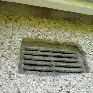

    Draught problem with metal vents on the wall
    Yes it is just for the larder in the kitchen, I think old larder was used to store the food but not anymore. Our electric cooker already has its own extractor hood plus our window has a small vent on top so I guess it might not be needed, I could cover it up on both inside and outside...
  16. B
    This vent is near the top of the exterior wall of the kitchen. It is the same on the other side of the wall, inside an old fashioned permanent larder and there is nothing in the cavity between two vent plates. There is draught coming in from the outside so is it ok to block both side of...
