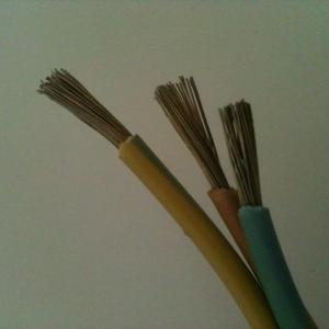

    Butyl Flex Conductors?
    Wiring up a hob in 4mm butyl, and exposed the conductors. They don't appear to be copper - is that normal for this type of flex, as I have never used it before.
